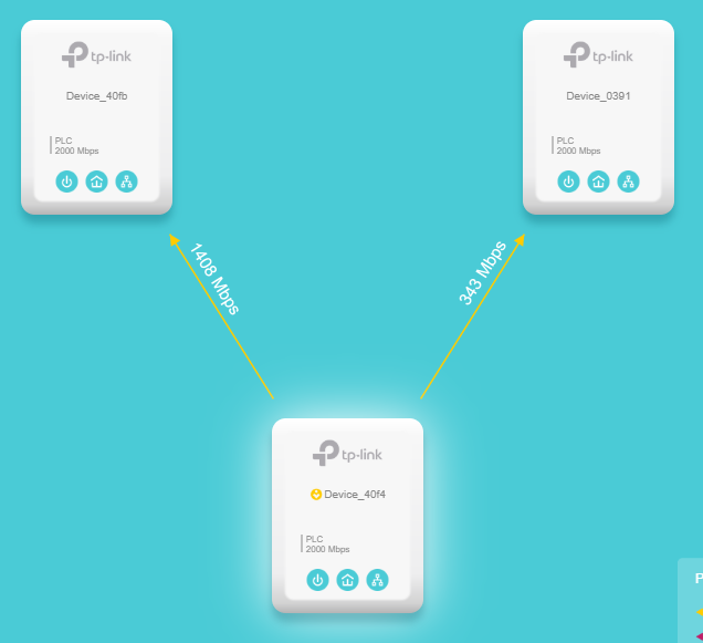

Powerline is a tricky technology. I have three TP-Link PA-9020P adapters. Two are on one electrical circuit. One is on another circuit. Using the tpPLC utility, they appear as one network:
Notice that the link between the two adapters on the same electrical circuit reports a "speed" of 1,408Mbps while the link between device 4014 (connected to the Orbi router) and the adapter on the other circuit reports a speed of 343Mbps. Previously, I had another adapter on that second electrical circuit, but even though it reported a "good" connection, after some random length of time, it would fail. (and I'd have to reset the damn thing, which involved crawling under a desk, etc. etc. Finally gave up on it.)
It would be useful to know what the tpPLC utiliity says about your Powerline adapters.
