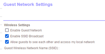

Roc1 wrote:
I think if the main NG SSID and the IOT SSID were truly separate WIFI networks, normally your device has to be on the same SSID to see devices attached to the network your device is connected to. Some how NG has two different SSID’s established, but their APP treats them as the same SSIDThe relationship between WiFi SSID and "network" is more nuanced. Orbi's primary network, which allows all devices to communicate with each other, is based on the IP subnet. Wired devices, Prinary WiFi SSID, and IoT SSID are all assigned IPs in the same subnet. Thus they all can communicate with each other. Devices connected to the Guest SSID are assigned IPs in a different subnet. In addition, Guest devices cannot communicate with any other device. (not even other Guest devices.)
Personally, I preferred the original WiFi5 Orbi method of managing Guest devices where the user has the option of allowing guest devices to "see" or "not see" other devices.
