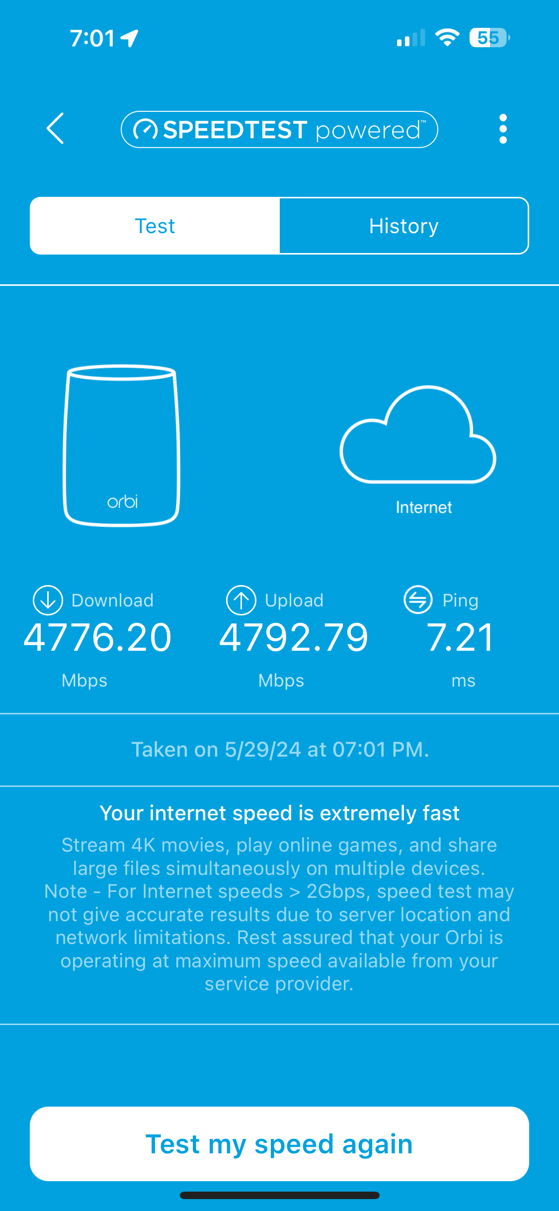

- Roc1May 29, 2024LuminaryCrimpOn, just to have a starting point, I just did the ORBi speed test. Take a look at the results.
- CrimpOnMay 29, 2024Guru - Experienced User
What 'mode' are the BGW320 and the Orbi in for this test?
(I think it's cute that the Orbi reports "extremely fast".)
- Roc1May 29, 2024LuminaryI’ve made no changes yet!! I ran an Orbi Spped test this morning which I just tried to attach, I’ve been saving them as png files which the file box says is acceptable. It shows it’s a png file, but the browse file thinks it’s some hec something file and knocks my reply off the community. The results with my existing config as ATT in pass through mode and Orbi in router mode gave me 4627.31 down, and 935.79 up at 9am this morning. You were just looking at the Orbi speed test results up/down close to 5Gbs!!! What the heck is going on???? It did this over the weekend for one day to. The Orbi Speed test on Sunday jumped up to the below attached speeds, but when I checked again Monday (no changes made!) they dropped back to the lower 1Gb on upload speeds and were low like that (per opening speed test) on Mon Tue, and at least until 9am today (Wed)!! What the heck is going on?!?!?
- Roc1May 29, 2024LuminaryBut that “extremely fast is a marketing lie!! If I could get my Orbi speed test from 9am this morning (4627 down and 935 up) to attach, it too says “Your internet speed is extremely fast” to!!! Sure they are, compared to my 1st internet service ADSL back in 1953!!!
- Roc1May 29, 2024LuminaryOk, I just did another internal Orbi speed test. Back down on upload right now (about 15-20 minutes after the attachment “extremely fast” test results in the reply I sent out a few posts below. Ok, it let me attach the current screen shot to this post.

- Roc1May 29, 2024LuminaryWell Community, I give up! I just ran another Orbi Internal Speedtest so, changing from Router to AP mode fast up/down speeds didn’t work very long. I give up, my Orbi is possessed!
