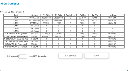

Reading of my log
Please explain my chart for me why is there so many zero on my sheet are these restarts ?
- Jan 25, 2025
1. the lan ones mean something isn't connected and transmitting data on those. Must only have something plugged into lan 1 and 2 (and lan 2 is just 100mbps link)
2. the backhaul tends to imply you're using a wired backhaul or have no satellites since nothings transmitting on them.
3. The 6ghz means you don't have anything connected to 6ghz.
4. Your 0 collisions means there hasn't been any traffic interference (good thing).
Nothing looks bad on that. Its all pretty standard.
FYI, thats you wan/lan port statistics, not the log 🙂
