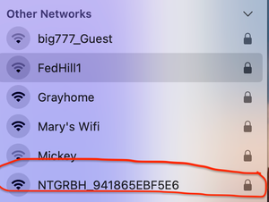

I just installed an Orbi 970 system, router and 2 satellites. I am on FW version 9.12.3.3. They went in place where a comparable Orbi 960 router and 2 satellites were. I set everything up by takin...

2. Is a known thing and not sure when NG will re-hid it. Been like this since the beginning of the 970 series. Just ignore it for now.
