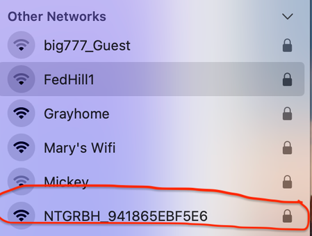

Several Bugs found in installing a Orbi 970 system
I just installed an Orbi 970 system, router and 2 satellites. I am on FW version 9.12.3.3. They went in place where a comparable Orbi 960 router and 2 satellites were. I set everything up by takin...
