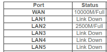

The ONT is irrelevant as wireless speeds are fine via the Orbi 971. It is some form of Adtran. It connects at 10000 as per the the screenshot.

The cable is CAT 6 connecting the ONT to the 10Gbps port on the ORBI. This is not an issue though as I've had speeds of 2Gbps going from the orbi via wireless which then uses this cable as the uplink to the ISPs ONT.
