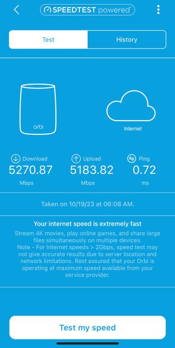

Nokia XS-010X-Q ONT. Highly unlikely it's related to the ONT in my opinion, as I've consistently received IP assignment from ISP, Speedtest is just fine up/down (over 5Gbps both directions). Cabling is good.

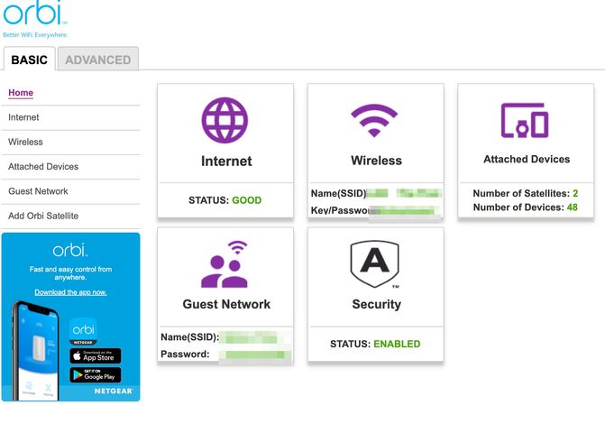

What is the CAT# lan cable being used between the RBR and ONT?
What does the Internet status show on the RBR web page under Basic tab?
- brianldOct 19, 2023Apprentice
Cabling is CAT6 and is fine. Below are a few more screenshots for context.
