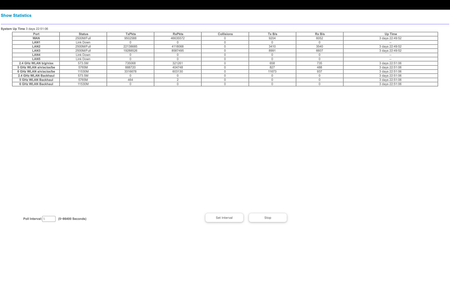

I upgraded to the RBE 971 with 2 RBE 970. I have Ethernet Wall Outlets. Router plugged into Arris S33 Modem. Both Satellites plugged into Wall outlets and into Router 2.5 . Web UI shows Wired. Not su...

Thank You, Which switch would you recommend? can you tell if I am getting any backhaul at all now. The only thing I see
is in the 5g backhaul is 464 Txpkts and 2 Rxpkts. They have not changed since set up last Sunday.

Yes the satellites are in ports 2 and 3. and say Wired in the web UI. Please bear with me I am not very Tech Savvy. So I should be looking at ports 2 and 3 TxPkts etc as the numbers for current backhaul and not the 3 last lines which spell out backhaul?
- FURRYe38May 23, 2024Guru - Experienced User
Correct.
