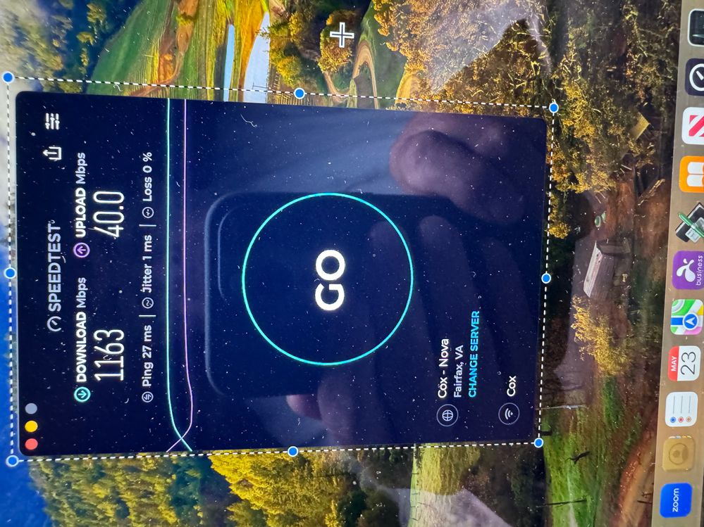

Thank You Sir. I pay for 1 Gig down and 40 MBS up and seem to be getting it. Would using a 10 gig switch(XS505m) and having the Satellites connected to the switch along with each Satellite connected to the wall plugs and the 10 gig port give me any benefits? Also how would you connect the Router to the Switch? I do not have Fiber. Thanks for your patience with me.
