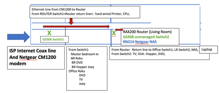

? Best Setup ? Modem CM1200, Router RAX200, 2 GS308 Switches, 1 RN214 NAS
I'm looking for the BEST Setup, Wired (see pic), Would aggregation help any? Modem: Netgear Nighthawk CM1200, Router Nighthawk RAX200, 2 Switches Netgear GS308, Netgear RN214 NAS. Office Desktop...
