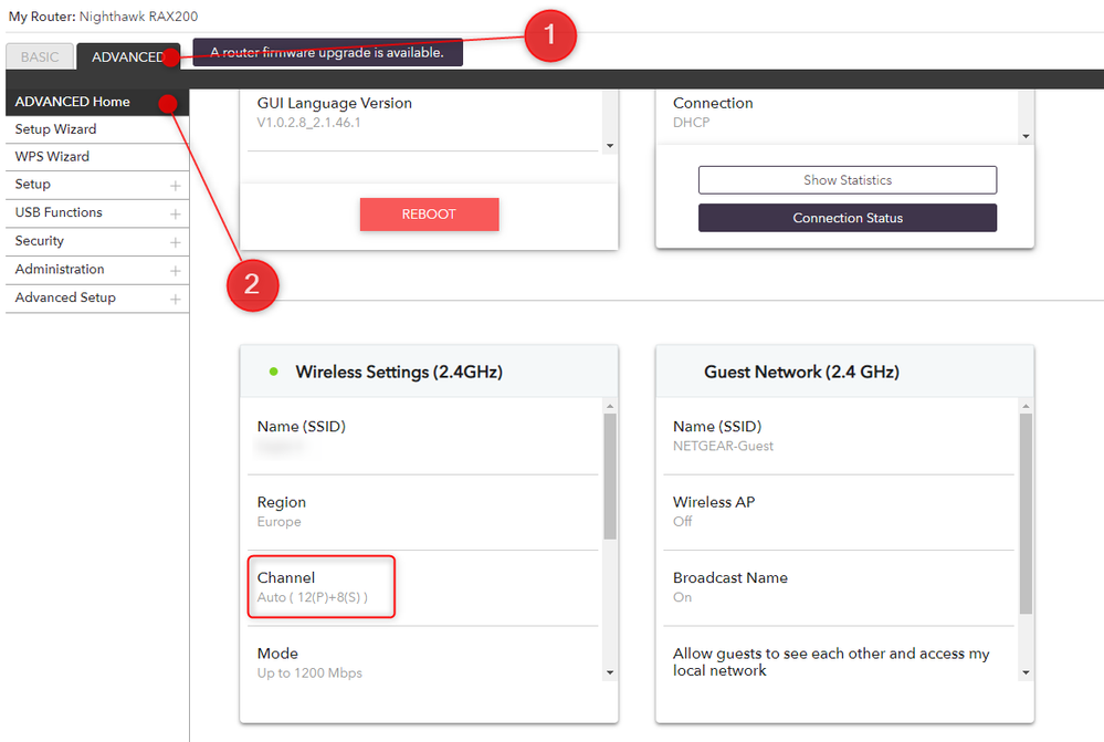

- piapiaApr 06, 2020Tutor
Yes, this where your can see the 2 channels. Here is mine :
If you do not have 2 channels, it means that your router is working at 20MHz. You might have activate the option "Enable 20/40MHz Coexistence" in your wireless settings. If you did so, the router will use 20MHz if it has not enough channels available to enable 40MHz.
