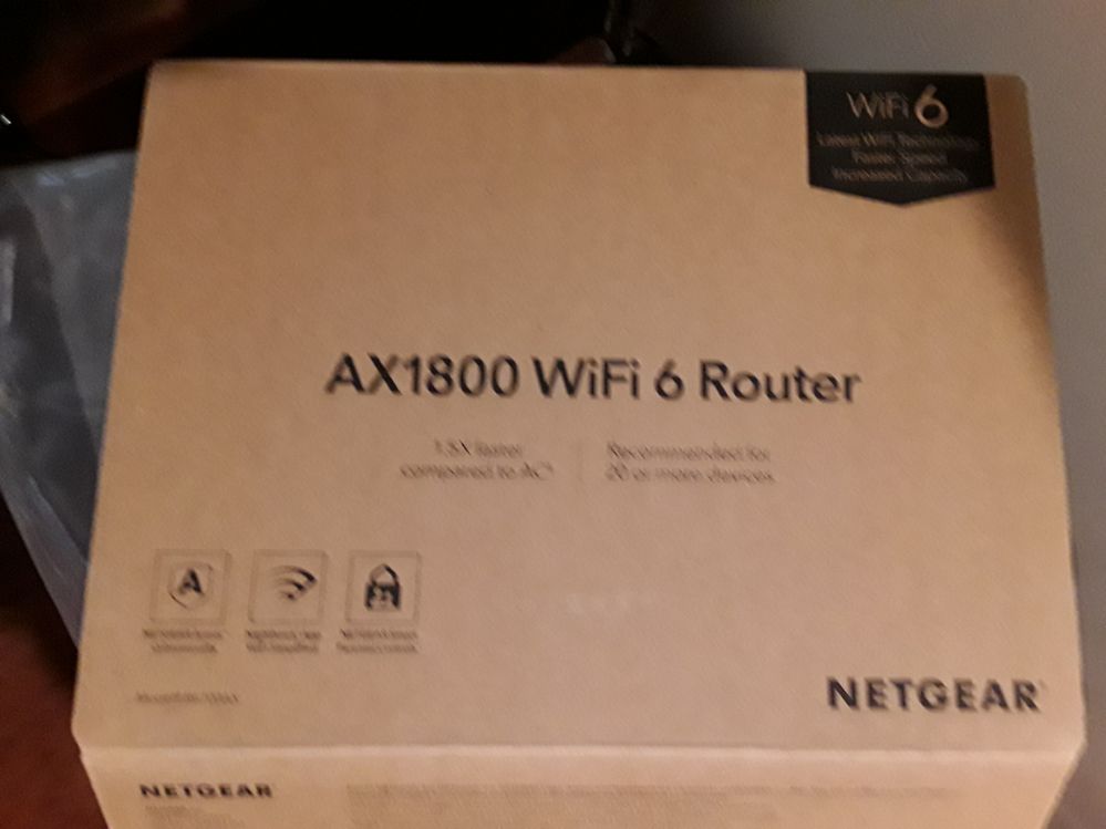

- Chris_CuomoMar 14, 2024Aspirant
If my post showed up twice, I have no idea how that happened. I only posted it once. Here's the package of the router I received from Amazon. I wasn't really expecting a plain brown cardboard box instead of retail packaging, but wasn't too immediately concerned. Now I'm wondering if I ended up getting a refurbished model that wasn't fully refurbished.
