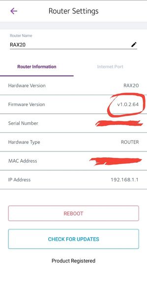

Hi experts, I am not sure why the testing results are so different. The same mobile, router (RAX20), ISP. Any thoughts? Thanks.
