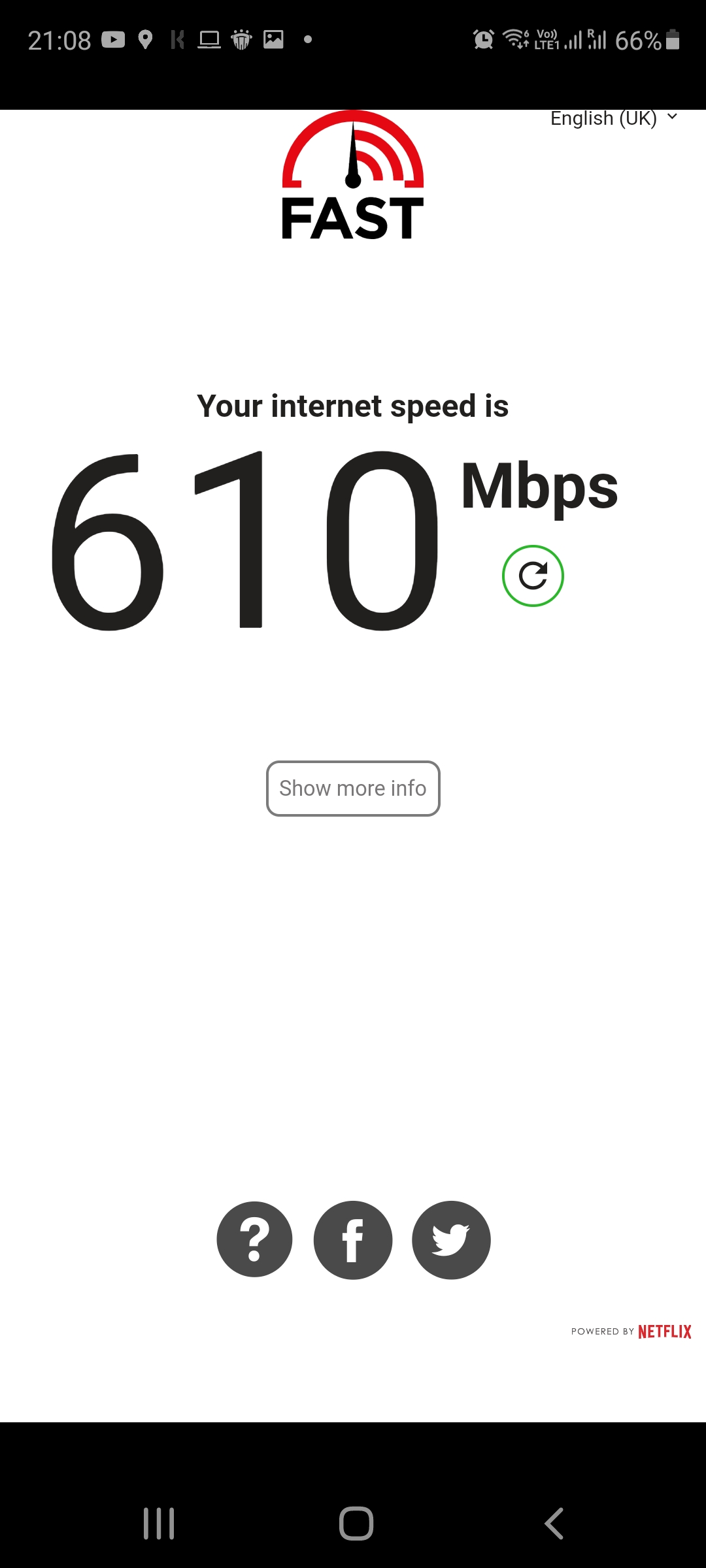

Hi experts, I am not sure why the testing results are so different. The same mobile, router (RAX20), ISP. Any thoughts? Thanks.

Dec 12, 2020Tutor
Ok, I think I found the root cause...
After I replaced the original Netgear's cable to high quality one, now my speed can run to 600Mbps...
