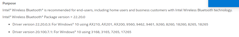

Hi, as noted before, the 20.20.0.6 version applies to the package. The actual AC201 driver is 22.20.0.3 is what is now installed. See the note from the Intel site below:
