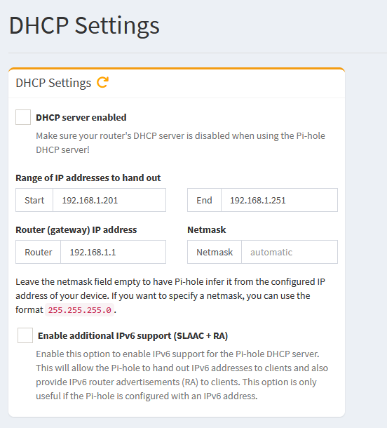

        Maybe a few screensnips of what you're actual settings for DNS are?

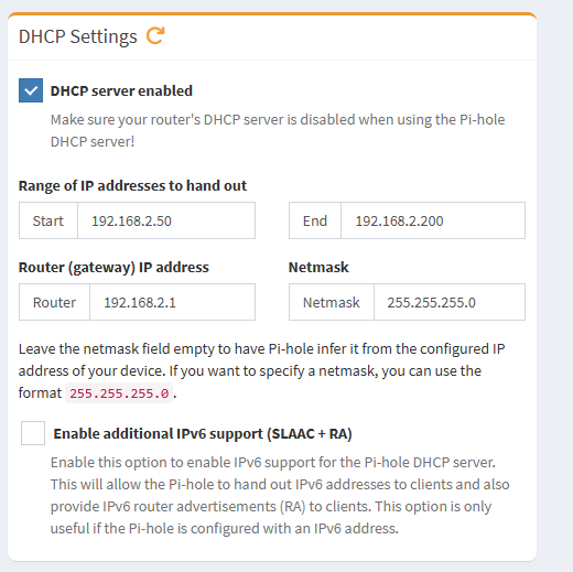

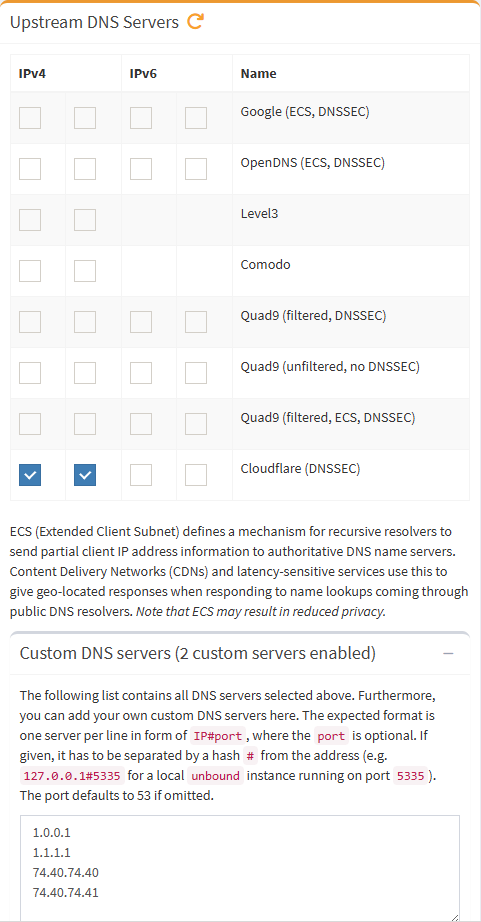

    Lest we stray too far from the original problem.  The goal is to configure a DHCP server that will pass specified DNS server IPs in the DHCP assignment packet (option 6), rather than pass the IP of the DHCP server itself.  The DHCP settings on my Pi-hole server do not show fields to set the DNS server values:

    How did you verify that the Pi-hole DHCP is supplying these DNS servers through Option 6 of the DHCP Offer?
    (I would do this by
    • Connecting a Windows PC/laptop and then looking at the values shown by ipconfig /all
    • or, using Wireshark to capture the actual DHCP conversation between computer and network. Display the DHCP packet and look at Option 6.

    Great that ipconfig /all confirmed that Pi-hole supplies custom DNS server addresses in the DHCP response.  It was not clear (to me) from the Pi-hole settings information that this is what it does.
