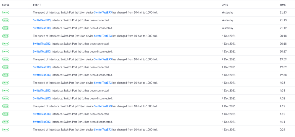

Here is a screenshot of what my ISP send me after they put the switch in to monitor my network. It seems as if the router keeps rebooting or something as it is kicking eth1 port out all the time.
So it is definitely not the ISP.
I put a ticket in with Netgear and see what they say. I might have to switch to a different brand if they cant fix it as it is 2 different Netgear devices with the same issue.
