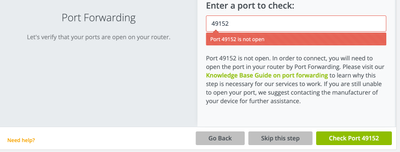

I have set up the port forwarding in the settings that NO-IP is requesting for the configuration but upon completing this step on there site (it scans to see if the port selected is open) it keeps saying the port is closed. Iv tried quite a few ports (currently have 49152 in my settings) but nothing is working. I was hoping for some assistance here on what port to chose, or how to open ports!

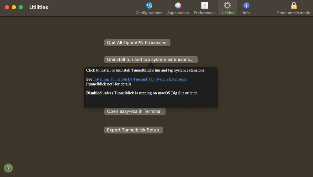

Next, after following the how to for Tunnelblick, part of the steps for Mac is installing the TUN and TAP system extension. When installing it through the program, nothing seems to happen. All permissions should be granted through my security settings so im not sure what to do here.
