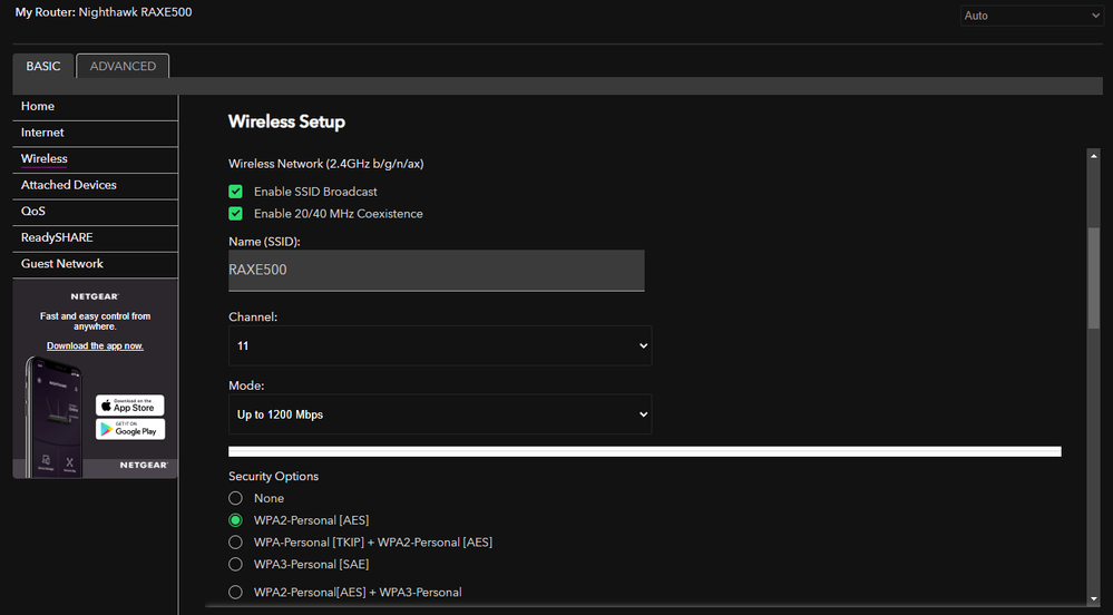

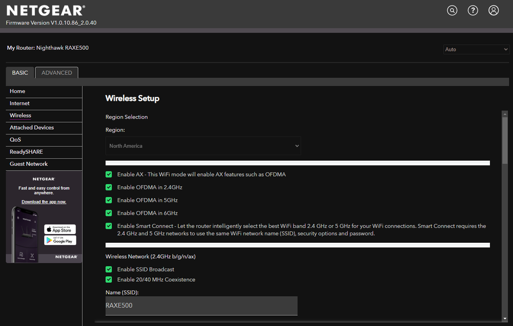

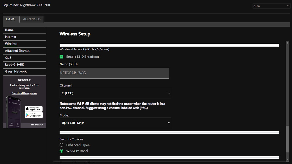

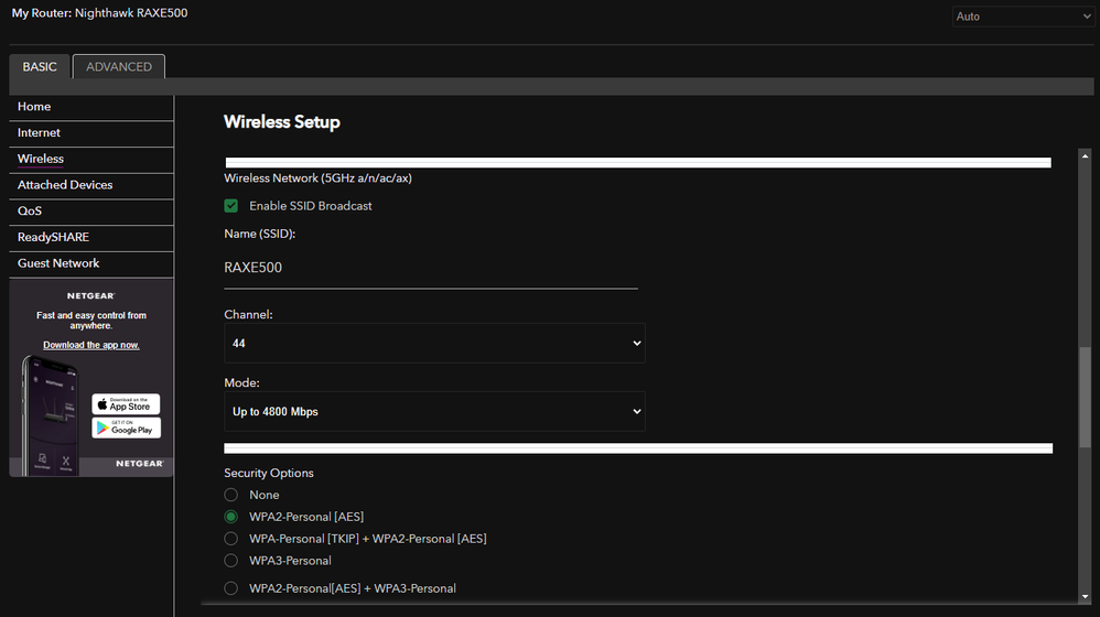

I did a factory reset on mine to check this and configured the following:
Used MS Edge. 4800 appeared to be default testing after the reset. I only enabled SC, OFDMA and changed the channels to what is seen here and applied the change.
