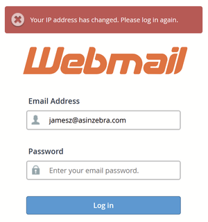

Cannot Connect To Roundcube Webmail. Various Errors On Login With RAX120 Router.
Router: Model# RAX120-100NAS AX6000 Gateway/Router To Internet: TMobile 5G Gateway Incompatible/Problem: Cannot Login To Roundcube Webmail with router connected to gateway ==================...

It sounds like you are piling router on router. That is an invitation to chaos.
Two routers on your network can cause headaches. For example, you can end up with local problems with addresses on your network. Among other things, the other router can misdirect traffic to addresses that the Netgear router usually handles, such as routerlogin.net or the usual default IP address for a router, 192.168.1.1.
I suspect that this is what gets in the way of your webmail services.
This explains some of the other drawbacks of NAT conflicts.
What is Double NAT? | Answer | NETGEAR Support
It is often easiest to use just one router and to set up the second router as a wifi access point (AP) with a wired connection to the main router. Netgear advises this, as does just about every site you will visit.
How do I change my NETGEAR router to AP mode? | Answer | NETGEAR Support
But that has its own drawbacks:
Disabled Features on the Router when set to AP Mode | Answer | NETGEAR Support
It may be possible to put the modem/router into modem only (bridge) mode and then to use the second device as the router.

In an attempt to troubleshoot, my friend lent me an older TP Link Router....Archer C90 AC1900.
This worked like a champ right from the get go. No issues with any webmail site. No issues with access to the network storage.
So, maybe I am sticking with the TPLINK router and sacrificing some speed.
- FURRYe38Jan 12, 2025Guru - Experienced User
I would give the DMZ on the host gateway router a try with the RAX120 and see if this helps.
Your double NAT condition will impact how the RAX120 and your web mail services work in that condition which should be avoided, either by using the DMZ or in AP Mode with the RAX120.
