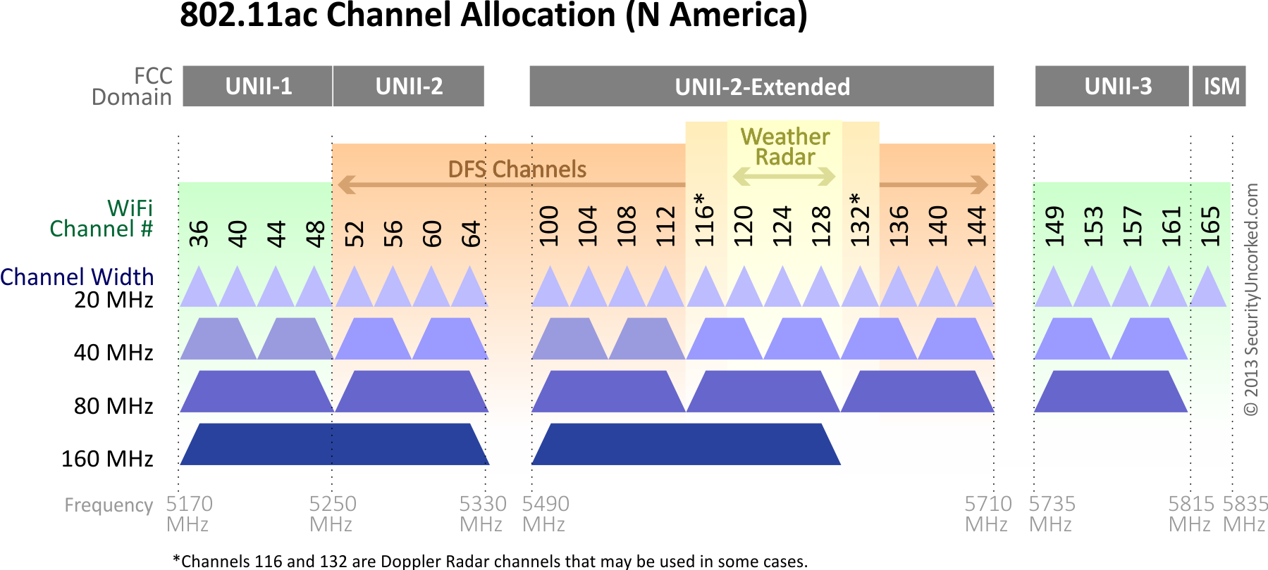

    I've got the same router and can put them both in 160hz mode.
    A single channel isn't 160hz, it overlaps over other channels and they need to be all together for full 160hz.
    160hz mode overlaps a lot of channels. 28 channels in fact. Because of this, there are only 2 regions in the 5ghz range that support 160hz wide channels. Channels 36-64 and channels 100-128.
    (I'll attach the graph that shows that.)
    That's the purpose for the 6e spectrum. It allows up to 7 regions that support 160hz.
    The region your in has the channels blocked/unusable in the zone that supports 160hz. . for the higher 5ghz band (100-128).
    It wouldn't matter which router you bought, because you're in the canandian region, those channels that support 5ghz are blocked because of Canandian broadcast restrictions.

        it could be region specific. 160hz wide channels need to use the dfs range of channels and it looks like there's some in the canandian region not usable.
        List of WLAN channels - Wikipedia
