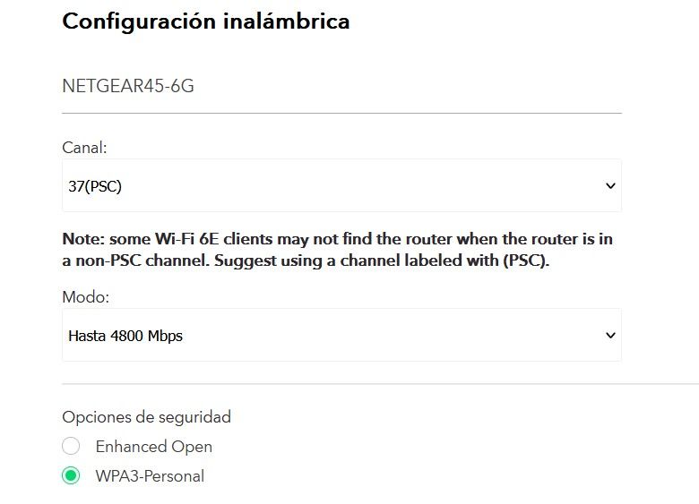

And is the 6Ghz LED On on top of the router?
Does the 6Ghz section appear on the Advanced Tab page on the routers web page?
Post a screen capture of this?
I have mine running in Bridge mode and had been working on 6Ghz with my Orbi 9 series. Now its back on 5Ghz with my 8 series Orbi system. I'll check this on mine when I get home today....
- MAD5Dec 06, 2022Tutor
Yes, the 6ghz led is on, as the same for 2,4 and 5 ghz. Also in the router I can see the configuration and it is "running" and also can see same information in nighthawk app. Support already take logs and send to a level 3 engineer to check where is the problem.
