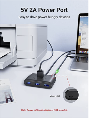

Hello, I was wondering if I used a true USB 3.0 splitter, could the AX8 recognize and configure the additional device in ReadyShare?
- Dec 14, 2022
This one...
UGREEN USB 3.0 Hub, 4-Port USB Hub with 3ft Extension Cable, High-Speed Portable USB Splitter for MacBook Air, Mac Mini, iMac Pro, Surface Pro, XPS, PC, Flash Drive, Mobile HDD
I'd like the number of positive reviews and that Mobile HDD was supported. So, I thought this might work.... and it did.

This one...
- plemansDec 15, 2022Guru - Experienced User
Looks good. The only thing I'd be careful of is that isn't a powered hub. And those routers don't put out a ton of power over usb. So if you're devices aren't powered, you might not have enough to run multiples. (just to be careful when plugging in more devices)
- dehinson64Dec 15, 2022Guide
Both of the WD Elements are powered enclosures. So, I believe I am in good shape. However, if need to power the USB HUB, it does have an option to do so...

Nice! Rare to see that anymore with the option to add it. good buy
