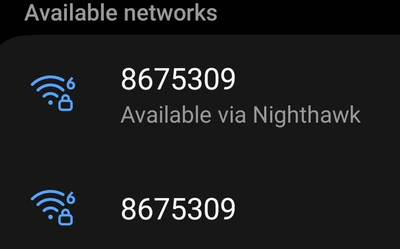

I just purchased a new Nighthawk RAXE500, primarily because my older Netgear EA7500 would stop serving the 5Ghz SSID so I got fed up and bought this...which now has worse issues 🙂
But the issue I'm having now is on our Samsung Galaxy S20's (all 4 in my house), are having issues with being connected without internet. My phone has the Nighthawk app, and the same SSID is listed as 2 separate options, but one says "Available Via the Nighthawk App" and the other does not. When connected to the one that does NOT say this, the problem of "Connected No Internet" exists. However, when I connect to the one that says "Available Via the Nighthawk App", it connectes fine and I do have internet.
I've disconnected and reconnected to the wifi SSID as well as rebooted the Nighthawk router, and the same issue exists.
What is the difference between these 2 SSID connections? Why is internet available via one but not the other?

    • chadwixk's avatar
      chadwixk
      FURRYe38 thanks for your reply.
      The power icon led is white. No other icons are lit.
      Turned off MAC Randomization on my phone, disconnected from wifi, reconnected...still no internet unless I connect to the SSID that says "Available via Nighthawk", then it works fine.
      That is how I set it to AP Mode. I have it set as a static IP, the same IP that the older router used (which is now unplugged from power and the network) and the static IP is not within the DHCP range.
      I can try moving ethernet cable to the Internet port later, but I'm thinking that can't be the issue if when I connect to the SSID that says "Available via Nighthawk", it works fine. What is this version of the SSID by the way? What is the difference?
      • FURRYe38's avatar
        That is how I set it to AP Mode. I have it set as a static IP, the same IP that the older router used (which is now unplugged from power and the network) and the static IP is not within the DHCP range. <The RAXE static IP configuration needs to be in the same DHCP Range. However not in the same pool range. Set a smaller DHCP pool range size on the host router, say 192.168.1.100 to .200. Then set the static IP address configuration on the RAXE to 192.168.1.50.
        I can try moving ethernet cable to the Internet port later, but I'm thinking that can't be the issue if when I connect to the SSID that says "Available via Nighthawk", it works fine. What is this version of the SSID by the way? What is the difference? <WAN port should be used for the main connection from the RAXE to the main host router.
        Is this how you set the SSID name on the RAXE? You can set the RAXE to any custom SSID name. Try something else. Something intuitive and fun. Use a web browser and PC to make the change on the RAXE's web page.
