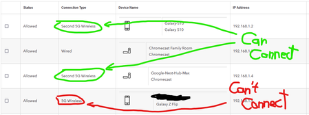

I was initially advised I would need the modem for connection to the internet. It turns out the RAX200 router can connect directly so I've removed the modem entirely. Rebooted the RAX200.I still have no clue why I can't always see devices in the house.
Here is a screen grab of both my Android and my partner's iPhone connected to 5GhzThese are the devices I can cast to
These are the devices my partner can cast to
Sometimes I see the same as my partner although if I disconnect and reconnect to the WiFi I might get the other list.
At first I thought it might be the phones connecting alternatively to 2.4 and 5Ghz and seeing corresponding devices, but the screengrabs were done while both were connected to 5Ghz, at least according to Router (as shown)
Any help appreciated.
