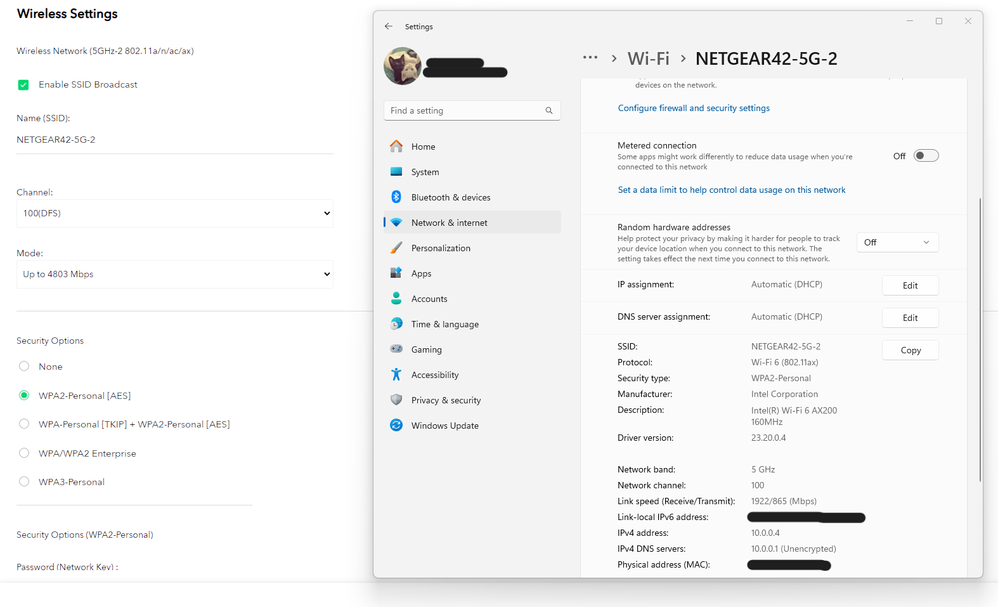

Danc90 you are right. I had Smart Connect Enabled and I didn't noticed. You can select 4803Mbps but only on DFS channels. In my area I'm pretty sure that there are radars for military use nearby. This might be a possible explanation why I have no SSID on 5G-2. Unfortunately (non DFS) channels above 149 are not available at all.

With a router not configured for Smart Connect (so no single SSID for neither the 2.4 GHz nor any of the two undoubtedly available 5 GHz networks, I would expect to see individual SSIDs (Network Names), individual channel selections, and individual security settings for each of the three three radios. All the screenshots (I assume we have screenshots posted from Australia [with a Europe setting] and from Greece [Europe] regulatory domain) appear to show only one set - tis leaves the impression bit your RAX70 are still appear to be configured for Smart Connect. Same behavior if doing a factory reset - just curious?

- Danc90Jan 16, 2024Initiate
Update: Make sure to reboot after changing region and speed. It took 5-10 mins and the SSID of 5ghz-2 finally appeared. I am now getting 2402/2402Mbps (Europe region, 4800Mbps mode, 128DFS) on some devices, up from previous 1200/1200Mps (Australia region, 2400Mbps mode). Currently using Firmware Version 1.0.5.108.
schumaku Smart Connect is off by default. I have left it disabled. I left out the screenshot of 5ghz-1. All three radios have options.
Great! Still try to
understand andexplain the readers here why Netgear can not make the 480x Mbps mode available for Australia (and Canada). There is no continuous 5 GHz channel range available in the regulations - the most obvious limitation is in the notch for Channels 120...128. This does very likely prohibit operating the system on 160 MHz bandwidth To reach 2402/2402Mbps max on just 80 MHz, one would need to use 4x4 clients - there are not many "out there". The popular and reliable Inhell AX and BE modules are 2x2 only.For my part, I'm just a "tire kicker" here in the consumer router section, more in Netgear SMB networking, and a co-editor of the https://en.wikipedia.org/wiki/List_of_WLAN_channels.

I reset everything to default this morning. Stock setting for 5G-2 was to 2401 Mbps Mode and Channel 100 (DFS). When I changed to 4803 Mbps Mode the 5G-2 SSID disappeared and came back after approximately 10 mins.
