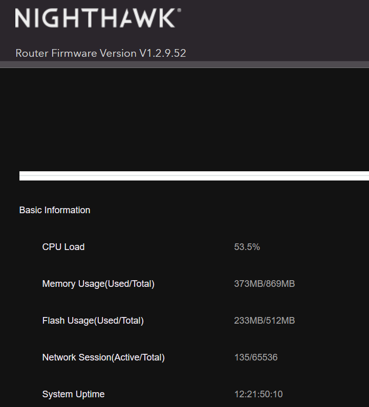

- Hot for sure but hotter I difficult to determine, 2 hrs after boot CPU 34%, Memory used 421MB/869MB, Flash usage 233/151MB, Yesterday when I checked the CPU load was 75% some hrs before ”issues” This "issues" might be heat/load issue!?

- Hot for sure but hotter I difficult to determine, 2 hrs after boot CPU 34%, Memory used 421MB/869MB, Flash usage 233/151MB, Yesterday when I checked the CPU load was 75% some hrs before ”issues” This "issues" might be heat/load issue!?Yes, if the CPU is getting this high, something maybe failing or causing the higher load to go up.
There is a Fan check feature in the debug page, please check this and enable the internal fan.

Enable the internal fan as well and please keep track of the CPU and memory usage.
Can you reduce the amount of devices connected if possible with leaving only most important and critical devices connected to see if the CPU load goes up after watching and tracking it?
