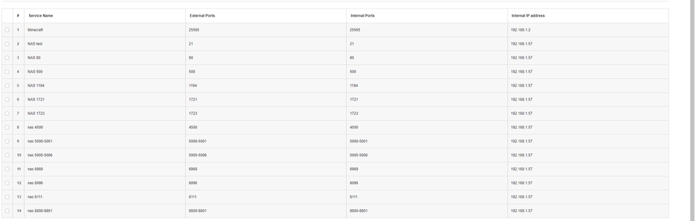

Fowarding multiple ports on RAX50
I am not able to foward multiple ports within a service. For example, if I enter "21, 80, 500, 5000-5001" and apply, only port 21 is forwarded (Pic 1 &2 is what I entered and what actually applied)....

din_dawn
Mar 02, 2022Tutor
I found out that I can foward a range of ports (eg. 1-100), but not putting different ports with comma. The problem remains if I go back to modify it. Thanks you help though
- plemansMar 02, 2022Guru - Experienced User
kind of a PITA but if you can add them individual it could work.
Luckily you don't have a ton.
Once you've done so, I'd make a backup configuration. That way if you ever factory reset, you can restore the port forwarding easier.
