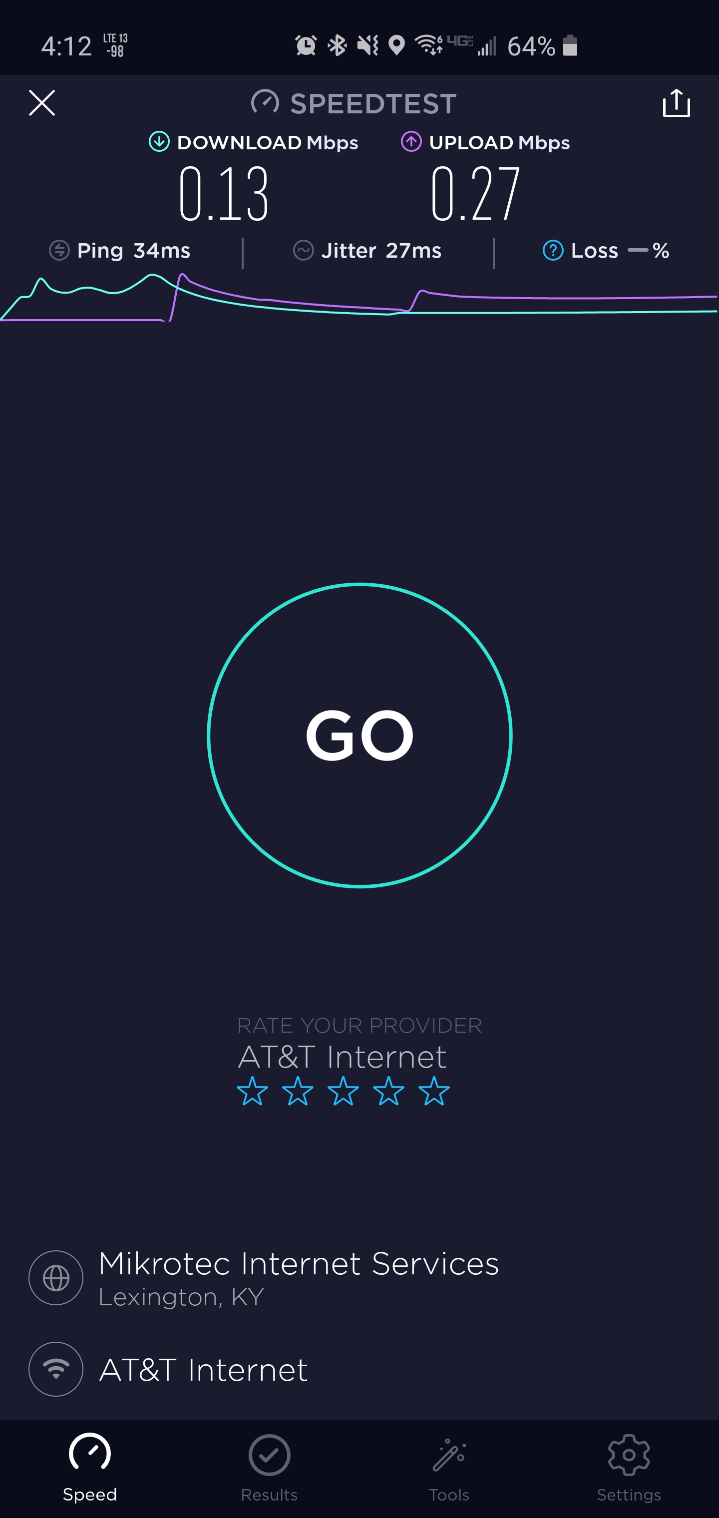

Horrible 2.4GHz Speed
I just exchanged my Google wifi at best buy for this new netgear RAX120. Unfortunately I can't exchange again or get a refund... I am stuck with this router that is worse. When using 2.4 within 10 fee...
- Feb 18, 2020Yes I found the issue. If you plug anything into the usb ports on the router it kills 2.4g. I unplugged my hdd from it and it instantly fixed it
