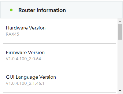

Hourly disconnections - RAX45 (Every 60 minutes exactly)
Router model: Night Hawk AX4300 Issue: For the past two weeks, every60 minutes, my connection will drop for 15-20 seconds, then restablish without issue and maintain without drops for 60 minut...
XliteChase
Nov 11, 2021Aspirant
A: V1.0.4.100_2.0.64 (Confirmed most up to date my GearHead support)
