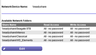

It should look like this:
They will appear on your network at \\readyshare
