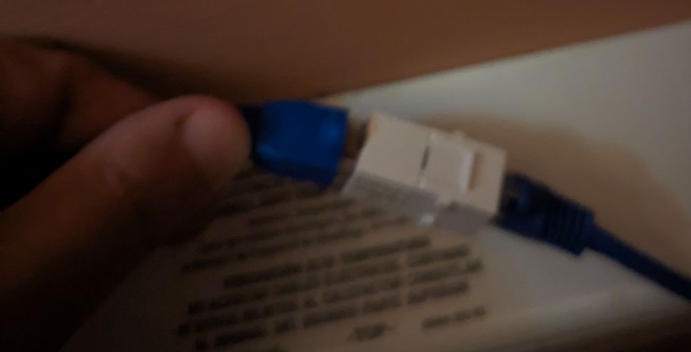

No switches involved, I do use two cables and a splitter. Will try using different cables as my next step if it doesn't work tonight when I plug in again. That didn't come to the top of my mind just because if it's causing the entire internet including wifi to go out I thought it IP or router itself related.
Please explain this in more detail.
In the days before gigabit Ethernet, it was common to use two pairs of a cable for one Ethernet connection and the other two pairs for a separate Ethernet connection. Gigabit Ethernet requires all four pairs, so this technique no longer works.
- IngloriousOct 07, 2023AspirantSure -- the router has to be in a different room so my PC is connected with two cables via a splitter to reach.
- CrimpOnOct 07, 2023Guru - Experienced User
Splitter is a very specific term. They are normally deployed in pairs
Can you attach a picture?
this is what I mean. I had my Ethernet cable unplugged for 4 hours with 0 issues. Within a minute of plugging my desktop back in my entire network went down again.
