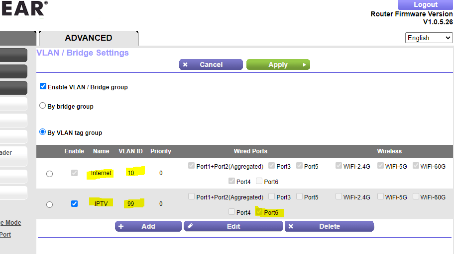

Configure the router VLAN grups accordingly - in my example the ISP side Internet runs on VLAN 10, the IPTV network does run on VLAN 99. One does have to configure only the Internet VLAN ID (if applicable) otherwise leave it on 0, and add one entry for IPTV with the VLAN ID where the IPTV is in place, and put it to a spare port on your router. Once done, direct connect or patch one media player/STB to this port. this must run first.

- schumakuJan 24, 2021Guru - Experienced User
Adding the missing screenshot of the example from above:
