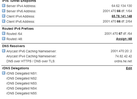

IPv6 6to4 tunnel option broken? RAXE500
RAXE500 firmware V1.0.10.86_2.0.40 I am having trouble getting my IPv6 tunnel to work with my new RAXE500. the settings are all entered correctly, and when i use the 'ping -6 ipv6.google.com' comman...

Fixing the ipv6 tunnel settings seems to have solved ALL my issues. not sure why incorrect ipv6 settings caused the router to act so flaky though. I do have one oddity to report however. the other day some of my devices (or the apps on the devices) started reporting a lack of internet connection, despite strong evidence to the contrary. today I went into the router's advanced settings only to fond that the IPv6 settings had reverted back from 6RD to 6to4. i switched the setting back, and strangely enough, the settings i had used for 6RD, were still entered. once i switched the settings back to 6RD, and the ipv6 LAN settings back to Auto Config, IPv6 started worki. ng again. the device and apps stopped reporting lack of internet connection as well.
