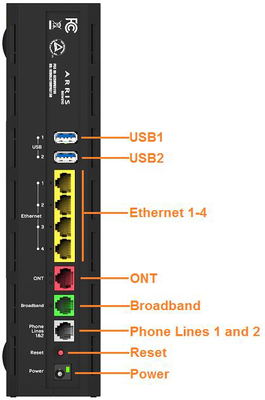

Is it possible to connect RAX50 router directly to the ONT box?
Hi guys, You know we have a law that ISPs cannot force the clients to rent their gateways anymore. I want to replace my ISP rented router (Arris BGW210-700) with AX50 router. My service is Op...

And the current ATT gateway is a DSL capable gateway. But as I am using FiOS, the gateway is NOT connected via phone jacks, but with a LAN cable from ONT box to the Internet/WAN/ONT port of the gateway.
I think this means the modem part of the gateway might not be functional.
