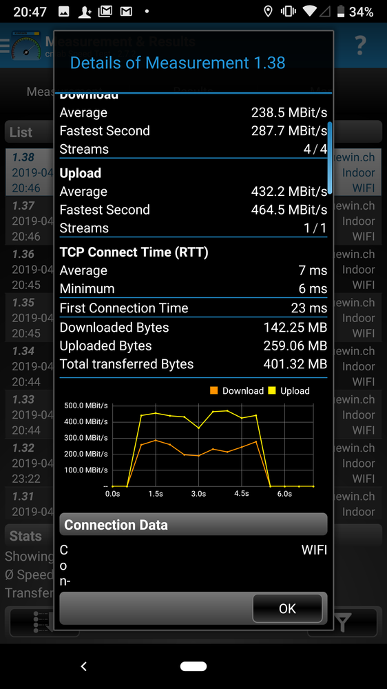

    I would return the S10, too: This is a Google Pixel 2 on an el-cheepo 80 USD Netgear WAC505 (a basic 802.11ac 867 Mb/s 2x2 MU-MIMO AP), no special test reservation, just pure ad-hoc test in the evening with the all the family members home - Fiber Internet connection, two UltraHD live video streams (different programs, ICMP multicast - on switched Ethernet, ISP 1.25 Gb/s total link rate, 1 Gb/s for Internet), two kids watching YouTube (different APs), and much more what is concurrently going on - and tested against the ISP speed test service.

        You still have not told us on how you run the speed test on the magic Wi-Fi 6 wireless link between mobile and router.
        Any indications of the PHY link rate of this connection?
