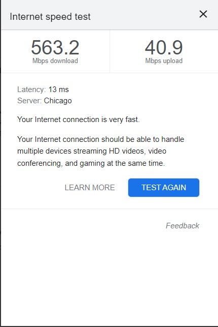

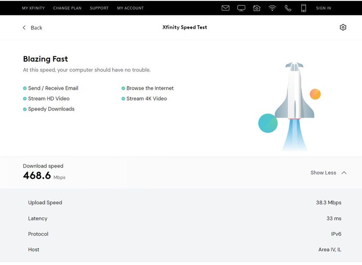

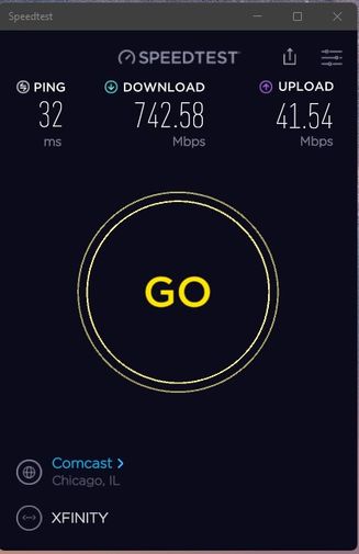

Sorry! I failed to mention that I am not using VPN. I do have Armor Security, so I tried disabling it and running speed test again.
Ookla App speed test :
Xfinity browser (Opera) speed test:
Google browser (Opera) speed test:
