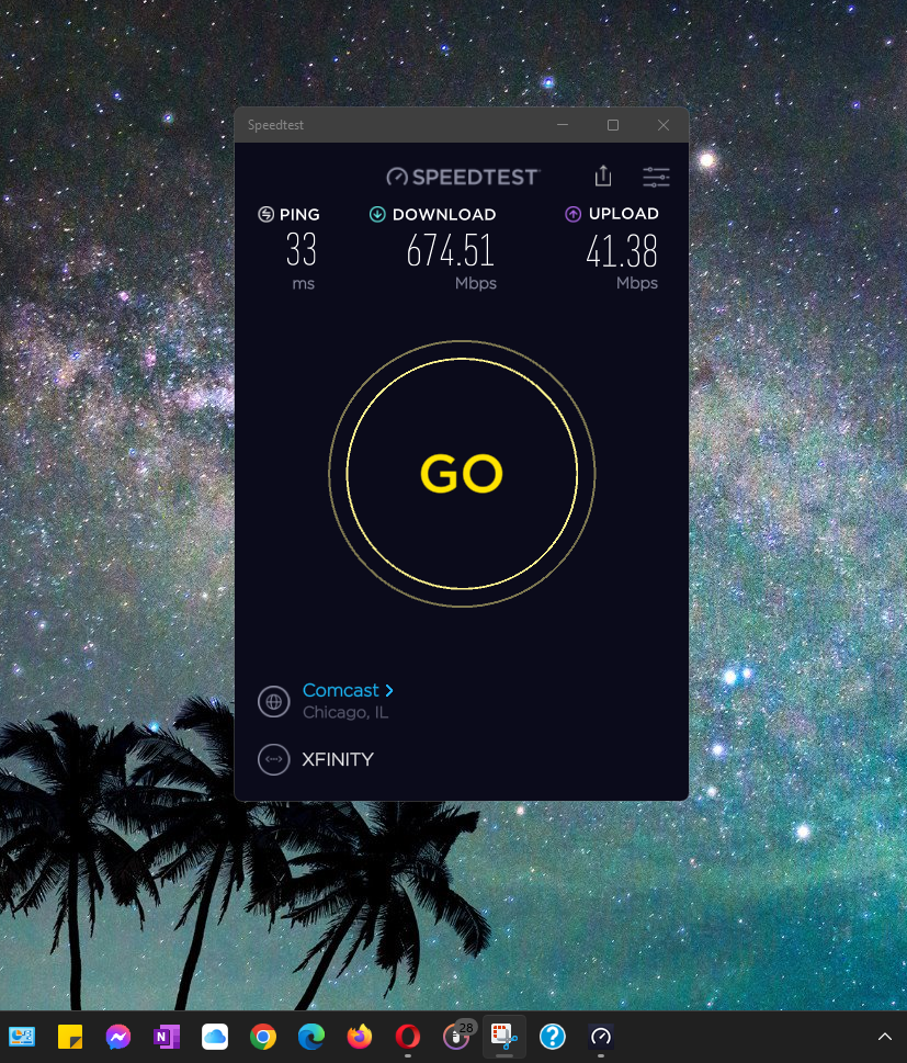

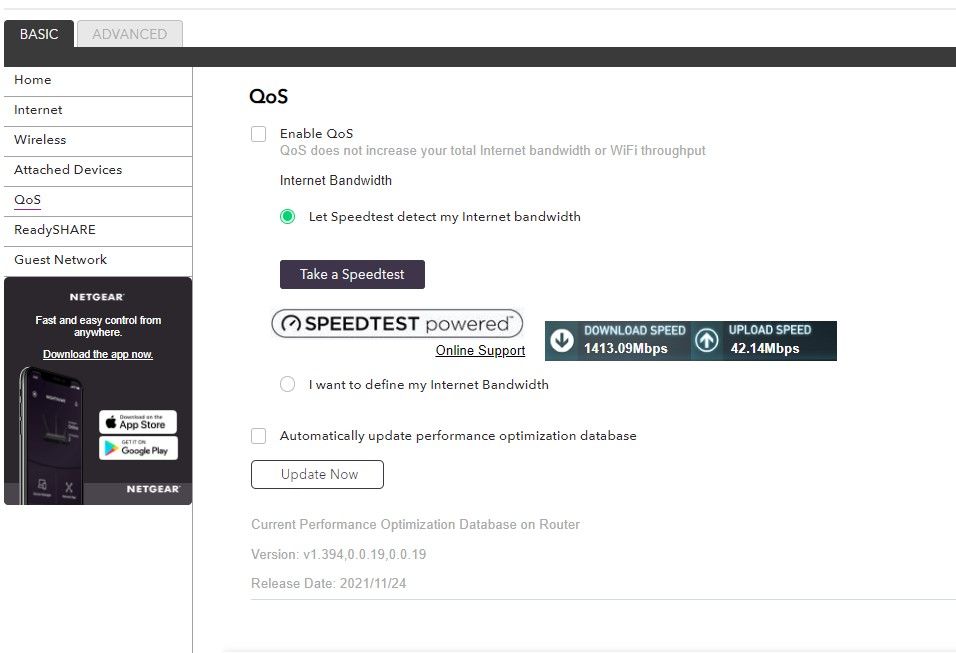

After trying new Cat6 cable, factory reset, default settings....nothing changed. I did notice that my laptop directly connected to the modem only produced 500-600 mps (per Ookla app on my laptop)? But modem connected to the 1gig port of the router, produced 950+mps... and modem connected the 2.5gig of the router produced 1400+mps per the router's Ookla speed test built into the Qos speed testing. Not sure why that is unless something in my laptop is limiting/restricting/downgrading the mps?? I've checked all the laptop's LAN/Ethernet adapter settings though. And disabled the Bit Defender Firewall/antivirus with no improvement?? Something I failed to mention... my house was prewired for cable when it was built in 2002. The cable comes into my garage from the cable/phone service box out in my front yard and splits to 5 different rooms/jacks. The current jack I have the modem connected to also has a dual splitter (provided by Xfinity) of which one goes to the modem and the other to a TV cable box. BUT, this is the same setup I had when I got the higher (950+) mps originally.... so.... I don't know?? I'm lost at this point.....

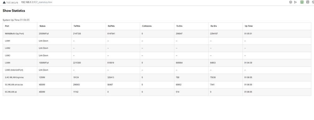

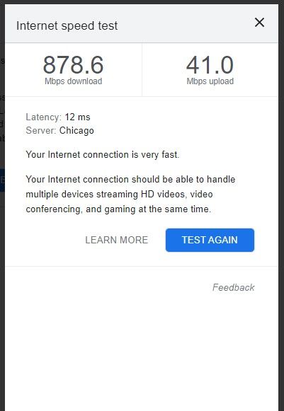

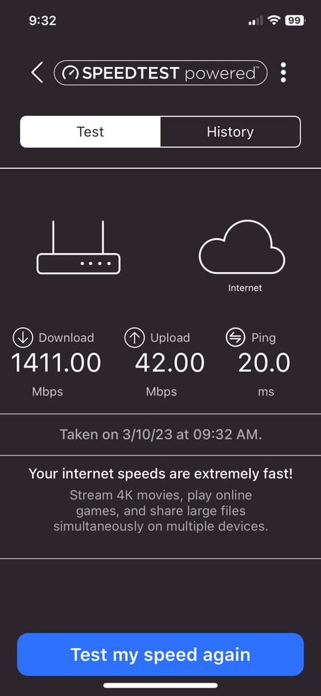

Just a few more tests from today. Still need to try the modem to router 1gig internet port and laptop connected to the router 2.5gig port. Router QoS Speed TestRouter Internet Port StatisticsiPhone NG Mobile App Router Speed TestLaptop Ookla Speed Test

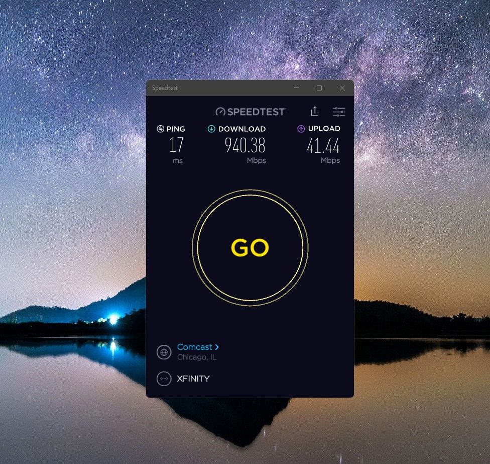

Sorry for the delay, but life has a way of distracting at times.

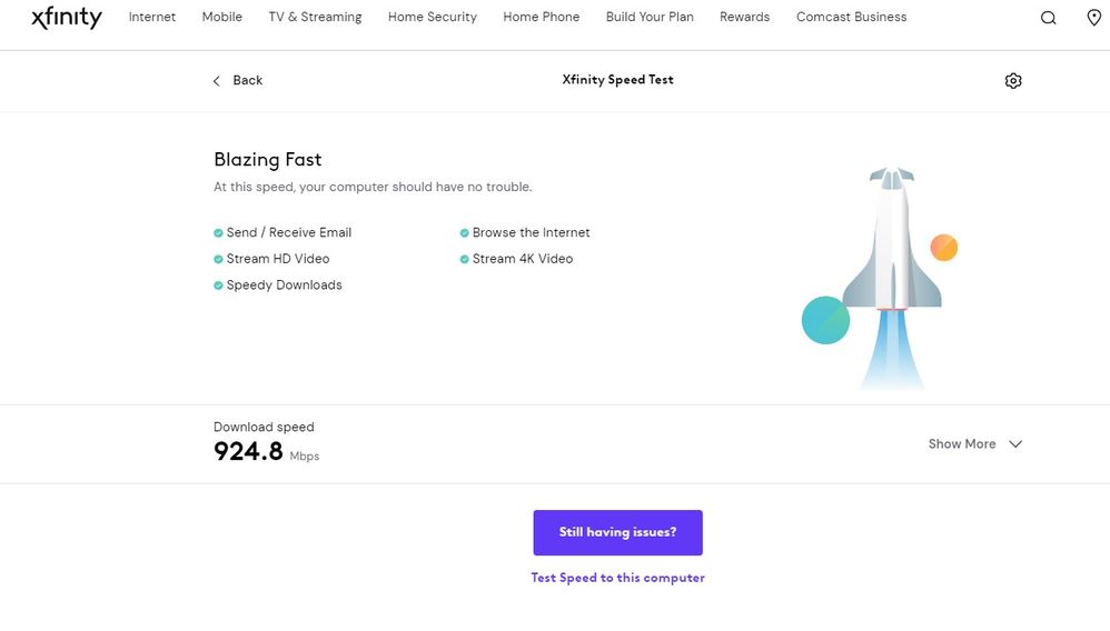

I wanted to come back and let you all know I finally did resolve this issue...at least to the point of getting 900+ mps back to my laptop. I ultimately decided to completely uninstall BitDefender and disable Armor on my router. So I'm flying with just Windows anti-virus and firewall protection. I used to use the free version of Avast for years. But this is ultimately what restored the higher 900+ mps to my laptop. I guess just disabling BitDefender, which I'd tried a couple times previously, does not stop it from throttling the bandwidth?? But as you can see from the speed tests, my laptop is back to 900+mps
