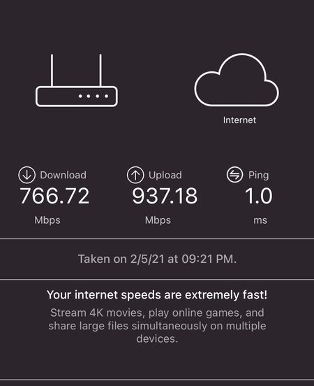

Low Throughput On RAX120
Here's the deal: I have a RAX120 AX12 router. I don't have any AX devices... this is not really about that, but I use pretty much a 2020 macbook pro and a iphone 11 pro primarily.. But I'm finding ...

Thanks-- I did see the photos didn't post so here's the details from them basically.
1) when running the test directly from the router (which I assume is *most* like plugging right into the ont line for Google Fiber), i was getting 750 down, 920 up
2) my mac shows that i'm connecting consistently at 900+ mbps to the router itself (using the option-click on wifi on the mac)
3) running a speedtest from my device, i'm seeing speeds between 2 and 300 mbps, the one i posted was even less than that.
I'm running firmware 1.2.0.16 on the router, not sure how to answer the ONT question... there's no box/firmware with Google Fiber, it's just a cable coming out of the wall.

sanderssam wrote:Thanks-- I did see the photos didn't post so here's the details from them basically.
1) when running the test directly from the router (which I assume is *most* like plugging right into the ont line for Google Fiber), i was getting 750 down, 920 up---You mean using the netgear app with speedtest built in?
2) my mac shows that i'm connecting consistently at 900+ mbps to the router itself (using the option-click on wifi on the mac)----Your link speed over wifi you mean? What wireless chip is in the mac?
3) running a speedtest from my device, i'm seeing speeds between 2 and 300 mbps, the one i posted was even less than that.----from your mac? from a different device? What device are you testing on? also, check which band. 2.4ghz is slow and sensitive to interference. what other deivces have you tried? Did you try changing servers on speedtest?
Totally get that AC shouldn't max out gigabit. but should also be better than what I'm getting I think.
- avtellaFeb 06, 2021ProdigyActually AC at HT160 can easily max out gigabit. I can get 140 MB/s (1,120) sustained 10ft away/one floor below the RAX120 with two of my laptops.
