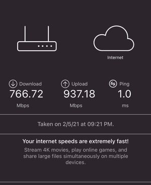

Thanks-- I did see the photos didn't post so here's the details from them basically.
1) when running the test directly from the router (which I assume is *most* like plugging right into the ont line for Google Fiber), i was getting 750 down, 920 up
2) my mac shows that i'm connecting consistently at 900+ mbps to the router itself (using the option-click on wifi on the mac)
3) running a speedtest from my device, i'm seeing speeds between 2 and 300 mbps, the one i posted was even less than that.
I'm running firmware 1.2.0.16 on the router, not sure how to answer the ONT question... there's no box/firmware with Google Fiber, it's just a cable coming out of the wall.
Totally get that AC shouldn't max out gigabit. but should also be better than what I'm getting I think.

sanderssam wrote:Thanks-- I did see the photos didn't post so here's the details from them basically.
1) when running the test directly from the router (which I assume is *most* like plugging right into the ont line for Google Fiber), i was getting 750 down, 920 up---You mean using the netgear app with speedtest built in?
2) my mac shows that i'm connecting consistently at 900+ mbps to the router itself (using the option-click on wifi on the mac)----Your link speed over wifi you mean? What wireless chip is in the mac?
3) running a speedtest from my device, i'm seeing speeds between 2 and 300 mbps, the one i posted was even less than that.----from your mac? from a different device? What device are you testing on? also, check which band. 2.4ghz is slow and sensitive to interference. what other deivces have you tried? Did you try changing servers on speedtest?

- sanderssamFeb 06, 2021Aspirant
1) Yes, i mean the built-in test in the app. I do understand this is the router directly running it rather than my device.
2) It's hard to get exact specs on the airport card included in MacBookPros, but it's a 2020 airport card that runs AC networking. connection links between the router and the computer are generally between 800 and 1300 Mbps. Using other routers before this, I had no problem in the exact same setup getting speeds between 7 and 800 Mbps at least.
3)I'm testing it on my mac consistently. I've tested on either my phone or my mac, and speeds never exceed 3-400 Mbps even right next to the router. I'm currently just using the 5g band of the router. I tried the following tips from the forums before this:
- disabling smart connect (combining 2.4/5 bands) and just using the 5g band
- disabling AX networking (I don't have any AX devices)
- making sure QoS was disabled.
But nothing pushes the bandwidth up. So I'm just trying to figure out if it's the router, the wireless connections on the router, or the connection itself.
