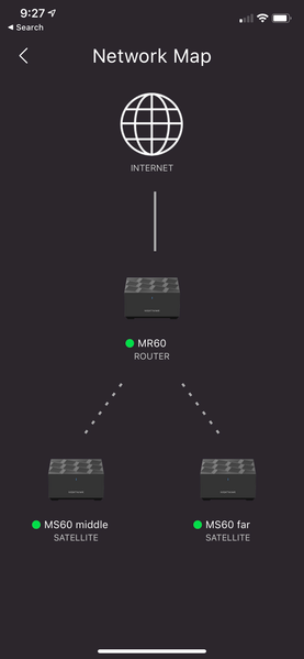

MR63 - How to make satellite connect to another satellite (instead of router)
Hi there, I have the MR63 Wifi 6 Mesh system with one router and two satellites. When I first installed this system I had the 'MS60 middle' satellite connected to the 'MR60 router' and I had the...

30 meters maybe too far between the MR and MS. Might try 10-15 meters and see if anything changes?
Also how you turn on the MS in sequence may help as well. Turn OFF The MS, Then turn on the first nearest MS to the MR. After that try turning ON the farthest MS.
If the farthest MS is connecting to the MR, try turning down the power output of the MR from 100% to 50%. Under Advanced Tab/Advanced Settings/Wireless Settings
