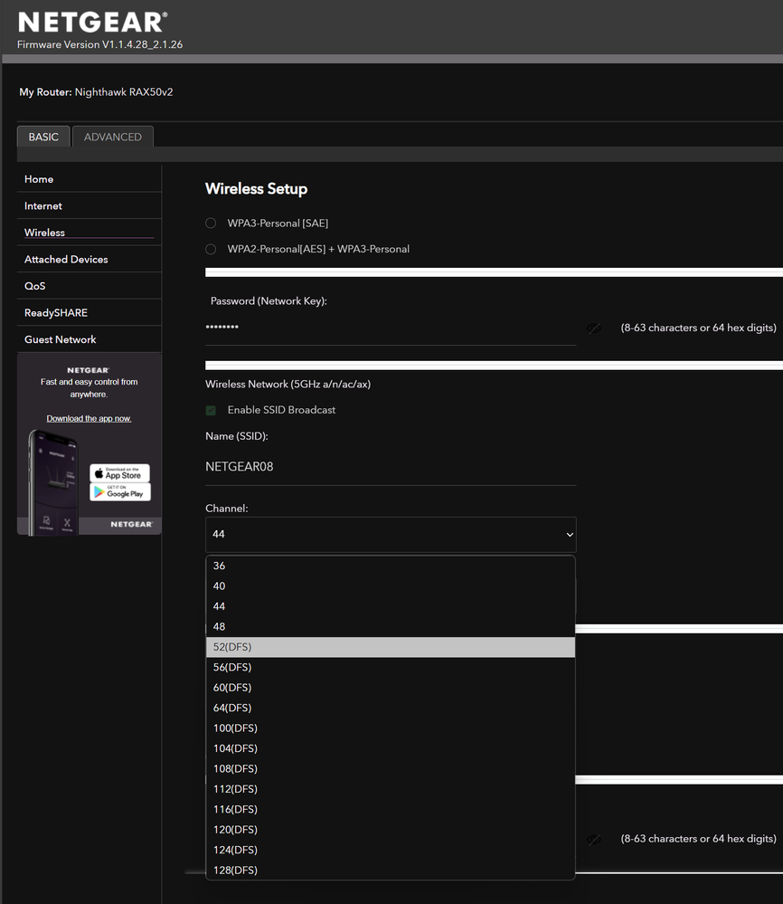

      • FURRYe38's avatar
        Checking my v2, DFS is seen:
        Mine's been factory reset and setup from scratch.
        Haven't seen others post about DFS missing on newer FW versions.
