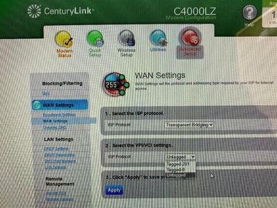

Netgear R6700AX AX1800 Router won't connect wirelessly...ENET working fine thru Router
R6700AX firmware ver: 1.0.15.146......Win10 Pro H22022...Centurylink modem automatically updates firmware! My INET thru ENET in router thru Centurylink C4000LZ in Transparent Bridge Mode (VPI/VCI...

Jun 18, 2024Aspirant
Sorry about the quality, thx 🙂
I have several years on both of you, but I have worked out how to get screen grabs using "Alt + PrintScreen".
Sadly, while I can just about read that picture, it isn't clear to me that you have the correct settings. Have you sought advice from your ISP?
It looks like this modem/router has caused other users problems with bridge mode:
Centurylink C4000LZ in Transparent Bridge Mode - Google Search
There are several promising links there. But it does boil down to a problem with the modem/router rather than the R6700AX
See this:
C4000 Modem Setup | CenturyLink
If that is the modem/router you own, I wonder why you want to dredge up the R6700AX. The CenturyLink books looks like it is younger and more capable that the Netgear router.
If it is a wifi range thing, you could use the Netgear in Access Point mode.
