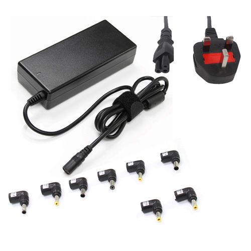

        Have you looked into generic adapters with sets of tips?
        Generic adapter
        Some of the transformers sold on line even lay claim to be compatible with Netgear devices.
        Netgear's devices seem to be pretty standard. I have various old power bricks lying around from old USB drives and the like that work just fine. The key requirement is the right polarity and voltage and enough amps.
