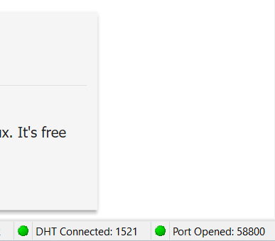

Hello Team Netgear, I have upgraded my Router to the latest firmware as of the time of writing this, and the problem of UPnP still persists. Here ismy configuration: OS: Windows 11 Pro PC: Asus...

I have another router in the room, Asus AC86U whose IP is set on DMZ on the Netgear RAX80 router and the app shows up in green, which means Asus is also forwarding the ports correctly through UPnP.

As I previously stated, I have a 2nd router (Asus AC86U) in the Room which is connected to the RAX80 router, and I've added the 2nd router's IP address in the DMZ on the Netgear RAX80.
I see the green status when my Laptop is connected to the 2nd router which means the port forwarding through UPnP works on that ASUS AC86U.
It's the RAX80 which is not letting me do it. But also, let me try to connect the 2nd router directly to the modem and check. I'll post back the results.
- sachbOct 21, 2022Tutor
Ok connected the other router to the modem, and it works like a charm. Green status, which means the Netgear RAX80 is buggy.
