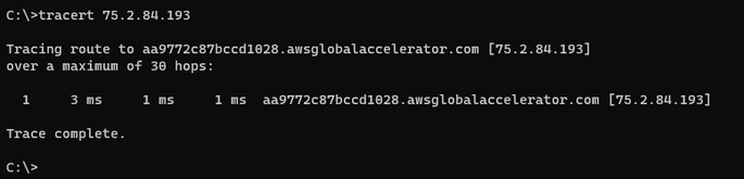

.128 FW still has an issue: RAX50 running V1.0.15.128_2.0.89 thinks it is 75.2.84.193
have not checked SSDP and other items, but fact Router responds to "75.2.84.193" (tracert) is very problematic. Wireshark trace shows this coming from MAC address of AP.

- duckwareDec 29, 2023Prodigy
.128 breaks UPnP queries. I reverted back to .120 and UPnP works again. Looks like Netgear messed up .128 FW.
