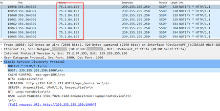

Netgear router in AP mode sending out SSDP packets with a public IP address
Netgear, you have a bad SSDP bug. When my RAX50 and RAX54 are in AP mode -- and on my LAN with a 192.168.1.XXX IP address -- the AP's are sending out SSDP packets with a incorrect source IP address ...

.128 breaks UPnP queries. I reverted back to .120 and UPnP works again. Looks like Netgear messed up .128 FW.
