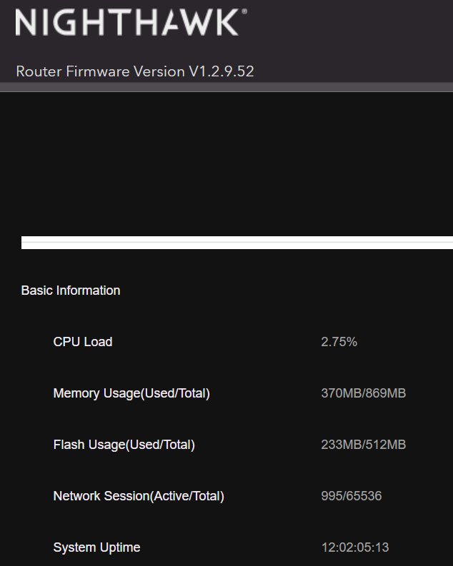

- FURRYe38Jan 30, 2024Guru - Experienced User
Retesting my RAX120v2, Seeing good 12 days uptime and low CPU usage. No Armor active.
I did see a spike in CPU usage one morning then came home that same day and CPU usage went back to being low. Not sure what that was about. Router as been working great on this version of FW.
