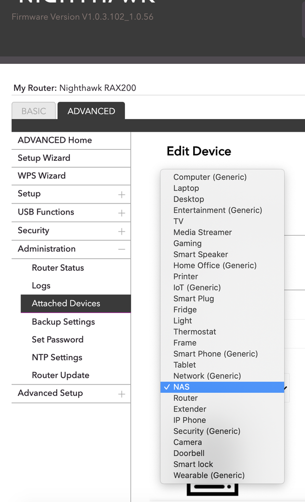

- rinthosOct 18, 2020Luminary
Also regarding the Device List, mine is still fine on 1.0.3.102. See attached screenshot showing device categories as well as the firmware version and device model....
